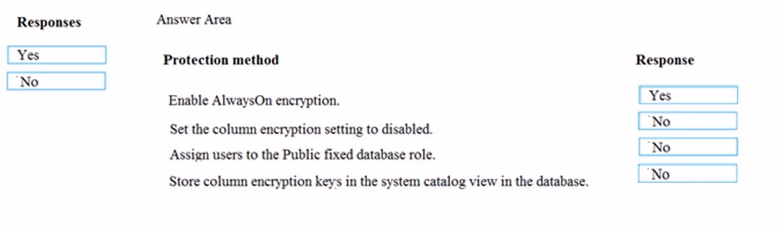

You maintain an existing Azure SQL Database instance. Management of the database is performed by an external party. All cryptographic keys are stored in an
Azure Key Vault.
You must ensure that the external party cannot access the data in the SSN column of the Person Table.
Will each protection method meet the requirement? To answer, drag the appropriate responses to the correct protection methods.
Each response may be used once, more than once, or not at all. You may need to drag the split bar between panes or scroll to view content.
Exam AZ-300 Question 152

YES/NO/NO/NO

agree with that Yes No Yes NO https://docs.microsoft.com/en-us/sql/relational-databases/security/encryption/always-encrypted-database-engine?view=sql-server-ver15 In SQL Database, the VIEW permissions aren't granted by default to the public fixed database role. This enables certain existing, legacy tools (using older versions of DacFx) to work properly. Consequently, to work with encrypted columns (even if not decrypting them) a database administrator must explicitly grant the two VIEW permissions.

You are correct but I am thinking each answer must be a correct solution. If you assign the public fixed data base role, you cannot just assume the column was encrypted. Therefore the only answer that presents a correct solution to the question is always encrypted setting.

Always On Encryption is just a typo... So answer is Y N N N

Always Encrypted != AlwaysON... so NO,NO,NO

Will be, NO,NO,NO,NO: Explanation: Enable Always Encryption, yes is good practice and you can configure it for individual database columns containing your sensitive data, but the question says AlwaysOn Encryption, so NO. Set Column encryption to disable, will leave to see information, we don't need it, so NO. Fixed Roles is bad practice and can be able to escalate privileges, so NO. Store Column encryption in system catalog view, doesn't make sense since it is the most efficient way to obtain, transform, and present customized forms of catalog metadata information, so NO References: https://docs.microsoft.com/en-us/sql/relational-databases/security/encryption/always-encrypted-database-engine?view=sql-server-ver15 https://docs.microsoft.com/en-us/sql/relational-databases/system-catalog-views/catalog-views-transact-sql?view=sql-server-ver15 https://docs.microsoft.com/en-us/azure/security/azure-database-security-overview

4 should be yes, the column keys are stored in the catalogue views https://docs.microsoft.com/en-us/sql/relational-databases/security/encryption/overview-of-key-management-for-always-encrypted?view=sql-server-ver15

Agree: NO | NO | NO | NO. Same as: https://www.examtopics.com/exams/microsoft/az-203/view/15/

I think this should be cell-level encryption, according to MS doc below, Cell-level encryption is available to encrypt specific columns or even cells of data with different encryption keys. https://docs.microsoft.com/en-us/azure/security/fundamentals/database-security-overview

Correct. Answer no,no,no,no Alwayson is for high availability and disaster recovery solution introduced when SQL Server 2012 was launched and above versions.

Completely agree unless there is typo in the answer and they mean always encrypted (there is no such thing AlwaysOn Encryption). If there is an error in the wording then it would be yes-no-no-no

This is certainly a typo in the question. It should be "Always encrypted" https://docs.microsoft.com/en-us/sql/relational-databases/security/encryption/always-encrypted-database-engine?view=sql-server-ver15

AlwaysOn dosent exist... Always Encrypted does... All No.

Always Encrypted is a feature designed to protect sensitive data, such as credit card numbers or national identification numbers (for example, U.S. social security numbers), stored in Azure SQL Database or SQL Server databases. So it should be "Always Encrypted" instead of "Always on Encryption". I think its a ttypo.

Yes, No, Yes, NO https://docs.microsoft.com/en-us/sql/relational-databases/security/encryption/always-encrypted-database-engine?view=sql-server-ver15 https://docs.microsoft.com/en-us/sql/relational-databases/security/encryption/overview-of-key-management-for-always-encrypted?view=sql-server-ver15

https://docs.microsoft.com/en-us/sql/relational-databases/security/encryption/always-encrypted-database-engine?view=sql-server-ver15 "You can configure Always Encrypted for individual database columns containing your sensitive data." So this should indeed work.

IMO, answer is N, N, N, Y. "AlwaysOn Encryption" not exists. MS purposely try to confuse us. Last one is how Always Encryption to store the column encryption keys.
