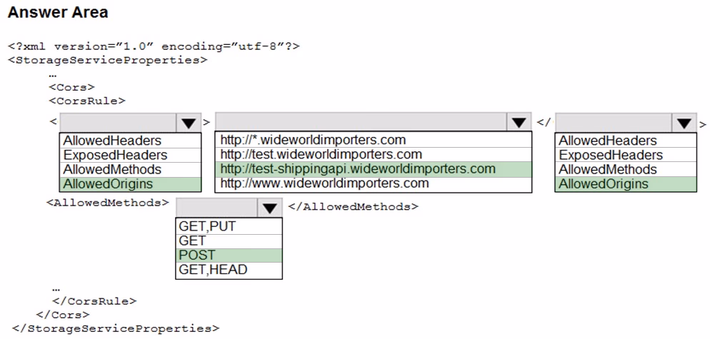

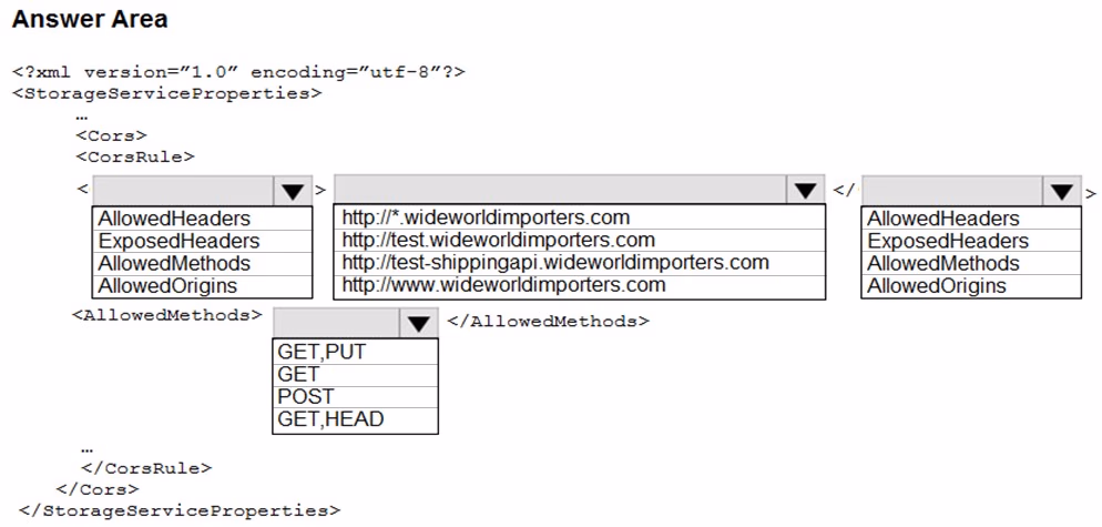

You need to resolve the Shipping web site error.
How should you configre the Azure Table Storage service? To answer, select the appropriate options in the answer area.
Exam AZ-203 Question 89
Box 1: AllowedOrigins -
A CORS request will fail if Access-Control-Allow-Origin is missing.
Scenario:
The following error message displays while you are testing the website:
Box 2: http://test-shippingapi.wideworldimporters.com
Syntax: Access-Control-Allow-Origin: *
Access-Control-Allow-Origin: null
Specifies an origin. Only a single origin can be specified.
Box 3: AllowedOrigins -
Box 4: POST -
The only allowed methods are GET, HEAD, and POST. In this case POST is used.
"" "allowedmethods" Failed to load no "Access-control-Origin" header is present
https://developer.mozilla.org/en-US/docs/Web/HTTP/Headers/Access-Control-Allow-Origin

Regimiento
Dec 11, 2019
Second box should be http://test.wideworldimporters.com, as that is the origin from the error message.
Zhang
Dec 24, 2019
Yes, agreed, second box should be http://test.wideworldimporters.com. the last box either POST or GET. GET is also acceptable.
balddie
Jan 17, 2020
I disagree, the error is happening in the API calling the function app.
PHARKGAOYOU
Jun 18, 2020
go study well and come back, don't make confusion over here. The answer is indeed 2nd Box
Chilred
Jan 9, 2021
Even if you are right, you could add the prove ;)
RT007
Jun 25, 2020
second box is the correct answer
Chilred
Jan 9, 2021
PHARKGAOYOU
Jun 18, 2020
Chilred
Jan 9, 2021
RT007
Jun 25, 2020
Chilred
Jan 9, 2021
balddie
Jan 17, 2020
PHARKGAOYOU
Jun 18, 2020
Chilred
Jan 9, 2021
RT007
Jun 25, 2020
Chilred
Jan 9, 2021
chintan4190
Mar 29, 2020
origin from the error message is without dot. it is "http://testwideworldimporters.com" where as in option it is http://test(dot)wideworldimporters.com.
oxaytol
Jun 14, 2020
In this case i think it is a typo error. The origin is http://testwideworldimporters.com, none of the choices matches this origin but if we assume the typo error, then http://test.wideworldimporters.com should be the answer
oxaytol
Jun 14, 2020
PHARKGAOYOU
Jun 18, 2020
Chilred
Jan 9, 2021
RT007
Jun 25, 2020
hikari_se
Sep 5, 2020
Agree, this problem comes when the origins test.wideworldimporters.com is not allowed for accessing container API. The XML configuration here is for the API, so we have to accept the origin comes from test.wideworldimporters.com
Juanlu
Nov 30, 2020
Agree. BOX 1 & BOX3 for "Allowed Origin" value. Agree. BOX 2 should be this url (http://test.wideworldimporters.com) , assuming typo error exists in "dot"(...test(dot)wide...) as @oxaytol said. Agree also por BOX 4. GET and POST, are correct, so this is a correct answer.
Chilred
Jan 9, 2021
Anonymous
Feb 7, 2021
Agree. For the last one, I think it should not include POST/PUT, because website only displays data. So, last one is either GET or GET, HEAD. I'd go with GET, HEAD.
dancsita
Feb 19, 2021
according to the Whizlabs you are right
AK89
May 27, 2020
2nd Box answer is correct as the request is generating from the website Url as given in the usecase. Although 4th box should be GET as the app is meant to display data as per the usecase
RT007
Jun 25, 2020
why AllowedMethod is Post it can also be Get. No where mentioned its using Post method
Gall
Feb 24, 2021
I would say it's POST as CosmosDB search query will be nested within BODY https://docs.microsoft.com/en-us/rest/api/cosmos-db/querying-cosmosdb-resources-using-the-rest-api
altafpatel1984
Nov 28, 2021
But here MongoDb is used, not Cosmos DB.
altafpatel1984
Nov 28, 2021
nikos2001
Jun 29, 2020
Website http://testwideworldimporters.com is calling the API. Web browser blocs the call, because this API is in a different domain. This API must me configured to accept calls from the source http://testwideworldimporters.com. https://docs.microsoft.com/en-us/rest/api/storageservices/cross-origin-resource-sharing--cors--support-for-the-azure-storage-services
chaudh
Jul 13, 2020
Box1 & Box3: AllowedOrigins Box2: http://*.wideworldiporters.com The question asks to resolve the Shipping web site error, not the testing. Use wildcard instead. https://docs.microsoft.com/en-us/rest/api/storageservices/cross-origin-resource-sharing--cors--support-for-the-azure-storage-services Box4: GET, PUT
chaudh
Jul 13, 2020
https://docs.microsoft.com/en-us/rest/api/storageservices/set-table-service-properties AllowedMethods Required if CorsRule element exists. A comma-separated list of HTTP methods that are allowed to be executed by the origin. For Azure Storage, permitted methods are DELETE, GET, HEAD, MERGE, POST, OPTIONS or PUT.
xofowi5140
Jul 15, 2020
For me that is not correct. I think only regex works or <AllowedOrigins> * <AllowedOrigins>
rrongcheng
Jul 29, 2020
I think the Bos 4 is: Get, Head, As it hasn't mentioned which CDN it uses, GET, HEAD is the best answer for Azure CDN from Microsoft. https://docs.microsoft.com/en-us/azure/cdn/cdn-how-caching-works
rrongcheng
Aug 5, 2020
It should be Get, as it's dynamic content so it will use Azure CDN from Akamai
Ave
Nov 7, 2020
both Get and Post are accepted https://docs.microsoft.com/en-us/azure/api-management/api-management-cross-domain-policies
Cornholioz
Dec 25, 2020
The link you pasted also mentions two origins: localhost and example.com. Does this mean 3rd option in Box2 could be right? Since the 2nd option has a typo. Maybe it's not a typo but simply a wrong answer?
mrpaul9
Jul 4, 2020
The answer provided is correct. Allowed Origin API Allowed Origin POST, GET If you have any doubt. The question is from Azure Storage Service perspective which is consumed by API. Please read the below https://docs.microsoft.com/en-us/rest/api/storageservices/cross-origin-resource-sharing--cors--support-for-the-azure-storage-services
xofowi5140
Jul 15, 2020
POST, GET is not an option
