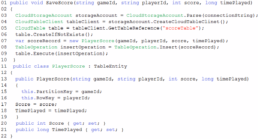

You have an app that stores player scores for an online game. The app stores data in Azure tables using a class named PlayerScore as the table entity. The table is populated with 100,000 records.
You are reviewing the following section of code that is intended to retrieve 20 records where the player score exceeds 15,000. (Line numbers are included for reference only.)

The code queries the Azure table and retrieves the TimePlayed property from the table: No. The query only selects the 'Score' property, not 'TimePlayed'. The code will display a maximum of twenty records: Yes. The 'Take(20)' method limits the number of records to 20. All records will be sent to the client. The client will display records for scores greater than or equal to 15,000: No. Because 'Take(20)' is specified, only 20 records will be sent to the client, not all. The scoreItem.Key property of the KeyValuePairs that ExecuteQuery returns will contain a value for PlayerID: Yes. 'PlayerID' is defined as the 'RowKey', and the 'RowKey' is included in the query results by default.

No,Yes,No,Yes

Third box should be NO. The client will get not all records, but those fitting the query filter.
godsbane
Jul 4, 2020
Box 3 is No. If .Take() is not specified, a maximum of 1000 records are returned to the client. There is no way all records are returned to the client, what if we have 20 mil records? Reference: https://docs.microsoft.com/bs-latn-ba/java/api/com.microsoft.azure.storage.table.tablequery.take?view=azure-java-legacy

Box 3: should be false, please suggest
VMCoder
Mar 16, 2020
Why do you think so? I think it is correct.
LEOPOLD
Apr 1, 2020
Same conclusion. I thought it would be deferred execution and iteration over the query with execute it so you have a query with .take 20 in it and when iterating you dont get all records sent to the client. (I sure hope thats what happens. Imagine that you had 2000000000 records in that DB all sent to client :D)
khrystyna
Apr 3, 2020
It can be because of method order: Select - get all records to client Where - in memory filtering on client side Take - return just 20 records

Ummara
Aug 14, 2020
the partition key is the game id, and select is not on the partition key. In such a case all records are retrieved, called Table Scan, and therefore Client will filter records from the data fetched.
Ummara
Aug 14, 2020
A Table Scan does not include the PartitionKey and is very inefficient because it searches all of the partitions that make up your table in turn for any matching entities. It will perform a table scan regardless of whether or not your filter uses the RowKey. For example: $filter=LastName eq 'Jones' https://docs.microsoft.com/en-us/azure/storage/tables/table-storage-design-for-query

Not all records, but only 20 records will not be sent to the client but written to the console
Praveen24by7
Jun 14, 2020
The code queries the Azure table and retrieves the TimePlayed property from the table - No The code will display a maximum of twenty records - Yes All records will be sent to the client. The client will display records for scores greater than or equal to 15,000. - Yes The scoreItem.Key property of the KeyValuePairs that ExecuteQuery returns will contain a value for PlayerID. - Yes

Third answer should be NO

Box4 should be "No" , we select just "Score" with "Query"
pranay
Jul 7, 2020
PlayerId is a rowKey so it will be returned anyhow. You don't need to mention rowKey and PartitionKey.
Juanlu
Feb 6, 2021
yes, but as I know, Partitionkey and Rowkey are also included by default, so de answer should be YES.
Juanlu
Feb 6, 2021
In my opinion, all answer are correct as the solution mention, so: YES, NO, NO, NO !

NO YES. YES. All record are retuned to the client. The máximum value are 1000. If so, tokenccontinuation returned and we can use: ExecuteQuerySegmentedAsync YES. By default PartitionKey and RowKey are already included by default in the select clause. https://www.examtopics.com/discussions/microsoft/view/16363-exam-az-203-topic-24-question-13-discussion/
