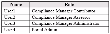

You have a Microsoft 365 subscription that contains the users shown in the following table.
Exam MS-500 Question 266
You discover that all the users in the subscription can access Compliance Manager reports.
The Compliance Manager Reader role is not assigned to any users.
You need to recommend a solution to prevent a user named User5 from accessing the Compliance Manager reports.
Solution: You recommend modifying the licenses assigned to User5.
Does this meet the goal?
Modifying the licenses assigned to User5 will not directly prevent access to Compliance Manager reports. Access to Compliance Manager is controlled by roles and permissions rather than licenses. To prevent User5 from accessing these reports, you would need to ensure that User5 is not assigned a role within Compliance Manager that grants access to those reports. Since there is no Compliance Manager Reader role assigned to any user, it implies that there is a default access setting that grants access. Modifying licenses wouldn't address this role-based access. Therefore, the recommended solution does not meet the goal.
