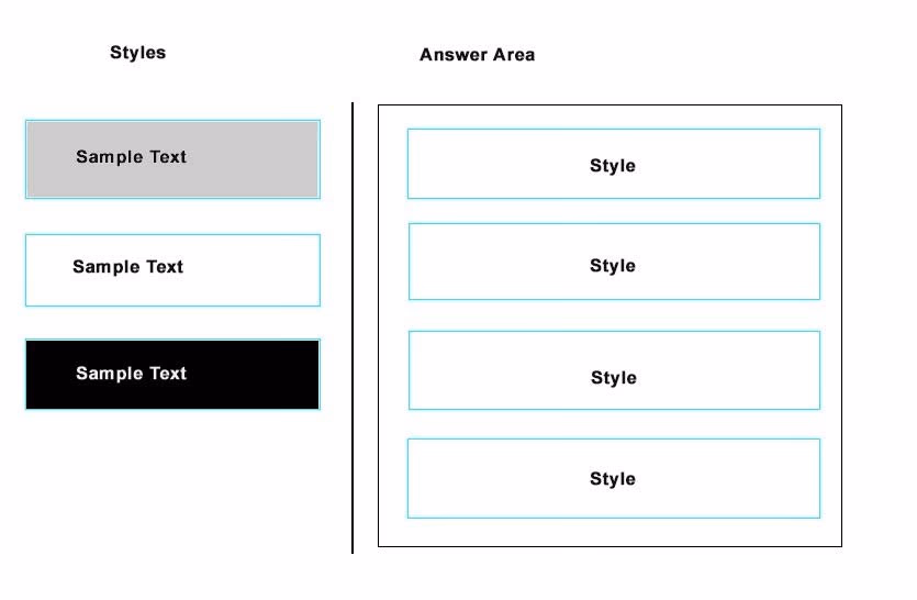

You are developing a corporate website for a company. The website uses a style sheet to enforce corporate image standards. Users report that the website is not properly rendering the styles.

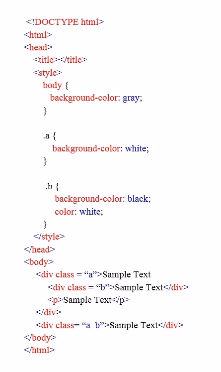

You create a web page to test the styles by using the following code.
Exam 70-480 Question 111
You need to verify how the style will be displayed.
In which order will the results be displayed? (To answer, drag the appropriate style from the list of styles to the correct location or locations in the work area.)

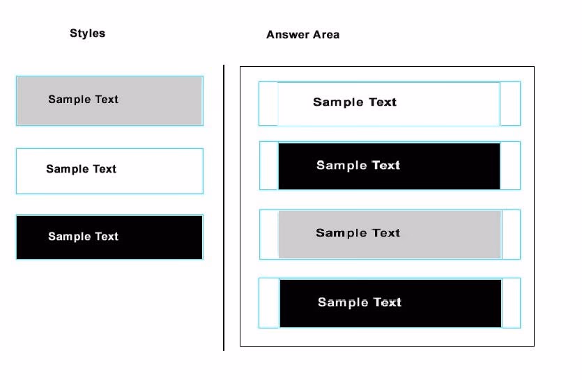

The correct order will be: white black white black Only the bodies background is gray.
Arcarnan
Oct 28, 2019
Tested, this is correct
JMz123
Nov 12, 2019
It is still white black white black. moderator: please have webmaster fix it and then remove comments of mogec and myself.
mogec39
Oct 1, 2019
white black black black
nootje
Oct 5, 2021
with body included it is gray, white, black, black. The paragraph is inside the first div so there is no additional styling for that
