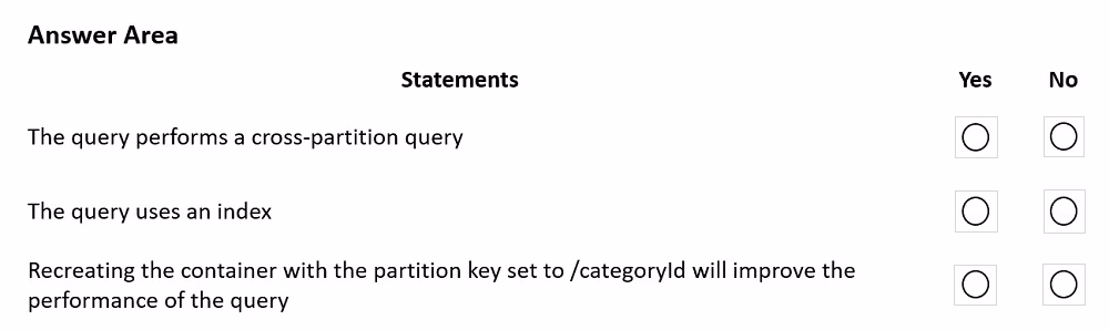

You have an Azure Cosmos DB Core (SQL) API account named account1.
In account1, you run the following query in a container that contains 100GB of data.
Exam DP-420 Question 119

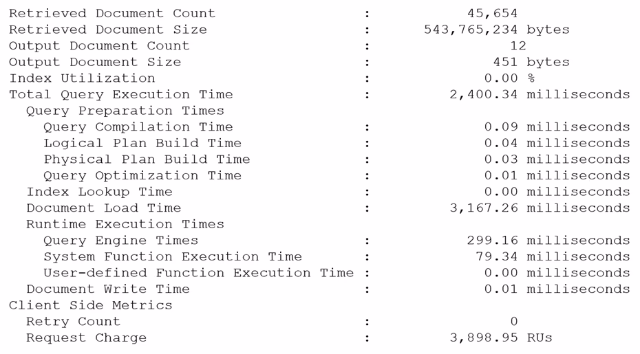

You view the following metrics while performing the query.

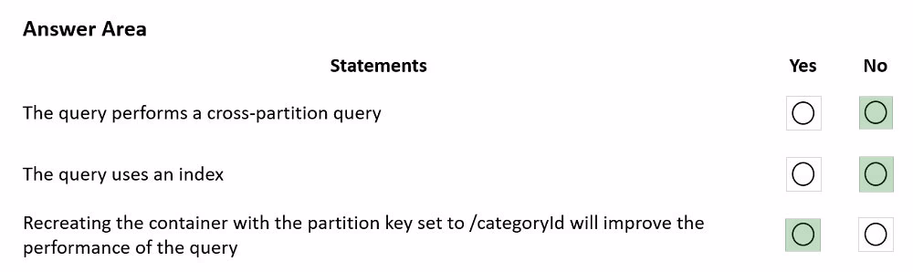

Box 1: No -
Each physical partition should have its own index, but since no index is used, the query is not cross-partition.
Box 2: No -
Index utilization is 0% and Index Look up time is also zero.
Box 3: Yes -
A partition key index will be created, and the query will perform across the partitions.

YNY "This query's filter uses the system function UPPER, which isn't served from the index." https://learn.microsoft.com/en-us/azure/cosmos-db/nosql/query-metrics-performance#scan-queries-commonly-slow-and-expensive
Mar 3, 2024
YNN < correction

8fe085a
Dec 6, 2024
The third question ask waht happens when the container is recreated with the customerid as partition key, so it is not currently the partition key, therfore the query is cross partition.
matejka
Mar 27, 2025
I would say YNY
WimTS
Apr 17, 2025
YNN When you apply the LOWER() function to c.categoryid, the query engine cannot determine the exact value of the partition key without evaluating the function. As a result, Cosmos DB cannot route the query to a specific partition and must perform a cross-partition query, which can be less efficient.
