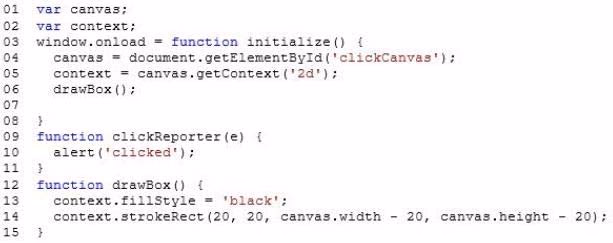

You troubleshoot a webpage that contains the following HTML element:
height= "300">Your browser does not support the HTML5 canvas.
The following JavaScript code is included in a script tag in the HEAD section of the webpage: (Line numbers are included for reference only.)
Exam 70-480 Question 42
You need to invoke the clickReporter() JavaScript function when a user clicks the mouse on the canvas HTML element.
What should you do?
To invoke the clickReporter() JavaScript function when a user clicks the mouse on the canvas HTML element, you need to assign the clickReporter function to the onclick event of the canvas element. This can be done by using canvas.onclick = clickReporter;. This way, when the canvas is clicked, the clickReporter function will be executed, displaying the alert message. Adding "clicked" as an attribute in the HTML is not valid syntax, and the other options do not correctly assign the event handler.

Arcarnan
Oct 23, 2019
A is incorrect, as clicked is not valid syntax. The correct answer here should be C.
JoelChuca
Sep 25, 2020
Yes, C is the correct. https://codepen.io/chobe/pen/QWNojKm
AOD01
Jan 22, 2021
Im test the code with response A and it's ok
PhiDang
Feb 29, 2020
The correct answer is C.
Etnic
Nov 14, 2019
both A and C worked for me.
stef1
Mar 30, 2020
A would be correct if it was: onclick= "clickReporter()" . C is correct and working perfectly.
RJGV
Sep 2, 2020
C is correct when I typed it all into repl.it
Lonan
Nov 25, 2019
Isn't it D?
nootje
Sep 28, 2021
The only correct answer is C. For A to work you need onclick instead of clicked
