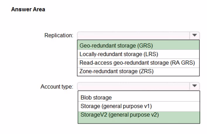

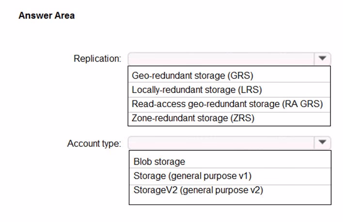

You plan to create an Azure Storage account in the Azure region of East US 2.
You need to create a storage account that meets the following requirements:
✑ Replicates synchronously.
✑ Remains available if a single data center in the region fails.
How should you configure the storage account? To answer, select the appropriate options in the answer area.
Exam AZ-103 Question 57
Box 1: Zone-redundant storage (ZRS)
Zone-redundant storage (ZRS) replicates your data synchronously across three storage clusters in a single region.
LRS would not remain available if a data center in the region fails
GRS and RA GRS use asynchronous replication.
Box 2: StorageV2 (general purpose V2)
ZRS only support GPv2.
https://docs.microsoft.com/en-us/azure/storage/common/storage-redundancy https://docs.microsoft.com/en-us/azure/storage/common/storage-redundancy-zrs

The Answer should be Zone not GRS.

The answer is already zone in the answer explanation of the question but the picture is misleading.

The site is good but questions like this one while you are reviewing the material doesn’t help. I understand you need to read carefully and so the explanation under the answer screenshot is good but the screenshot threw me off. Box 1: Zone-redundant storage (ZRS) Zone-redundant storage (ZRS) replicates your data synchronously across three storage clusters in a single region. LRS would not remain available if a data center in the region fails GRS and RA GRS use asynchronous replication. Box 2: StorageV2 (general purpose V2) ZRS only support GPv2.

You are wrong, they ask for synchronously replication, and the given answer was GRS that geo is asynchronously. So the correct answer is ZRS.

GRS is incorrect: it runs asynchronously Correct is ZRS: Runs synchronously and keeps working in the case of a single datacenter (or availability zone) failure, but not in the case of an entire region failure.

Only the image is wrong. In detailed answer, it is ZRS and V2 which is correct..
