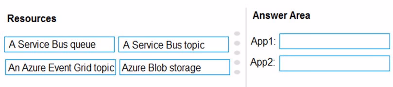

You have an Azure subscription that contains an Azure Service Bus named Bus1.
Your company plans to deploy two Azure web apps named App1 and App2. The web app will create messages that have the following requirements:
✑ Each message created by App1 must be consumed by only a single consumer.
✑ Each message created by App2 will consumed by multiple consumers.
Which resource should you create for each web app? To answer, drag the appropriate resources to the correct web apps. Each resource may be used once, more than once, or not at all. You may need to drag the split bar between panes or scroll to view content.

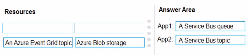

Farid77
Jul 2, 2021
Correct "A queue allows processing of a message by a single consumer. In contrast to queues, topics and subscriptions provide a one-to-many form of communication in a publish and subscribe pattern." https://docs.microsoft.com/en-us/azure/service-bus-messaging/service-bus-queues-topics-subscriptions
rdemontis
Jul 14, 2021
Sep 4, 2021
single consumer -> topic multiple consumers -> queue
asemaan
Sep 24, 2021
the answers are backward single consumer -> queue multiple consumers -> topic
Sst121
Nov 29, 2021
Correct https://medium.com/awesome-azure/azure-difference-between-azure-service-bus-queues-and-topics-comparison-azure-servicebus-queue-vs-topic-4cc97770b65
Sst121
Nov 29, 2021
