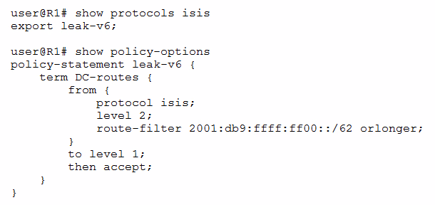

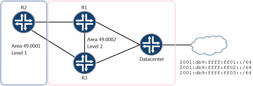

A network designer wants to ensure that traffic from R2 destined for 2001:db9:ffff:ff00::/62 always traverses the R2-R1 link if that link is available.
Referring to the exhibit, which configuration change will satisfy this requirement?

To ensure that traffic from R2 destined for 2001:db9:ffff:ff00::/62 always traverses the R2-R1 link if that link is available, the correct configuration is to export the specific route from Level 2 to Level 1 on R1. This will allow R2 (which operates as a Level 1 router) to receive the route and prioritize the R2-R1 link for traffic to the datacenter. Given the configurations provided, the correct answer is A. This configuration correctly exports the route from Level 2 to Level 1 on R1, thus fulfilling the requirement.

Juniperguy
Aug 13, 2021

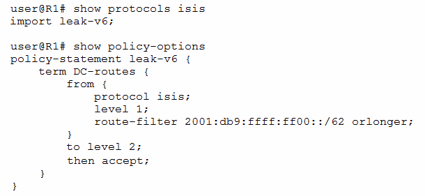

Agree with Answer A. 1# the config has to be done on R1, as R1 is in Level 2 and has to export the route to layer 1. Answer B is the wrong router to do configuration on and C is routes from area 1 to area 2.

oceans1908
Feb 11, 2022
A on router 1 the l2 l1 router

ztw3587t
May 24, 2023
A is correct
ztw3587t
Jun 12, 2023
A is correct because the configuration must be applied on L1/L2 Router and also it's necessary be applied on L2 route.
