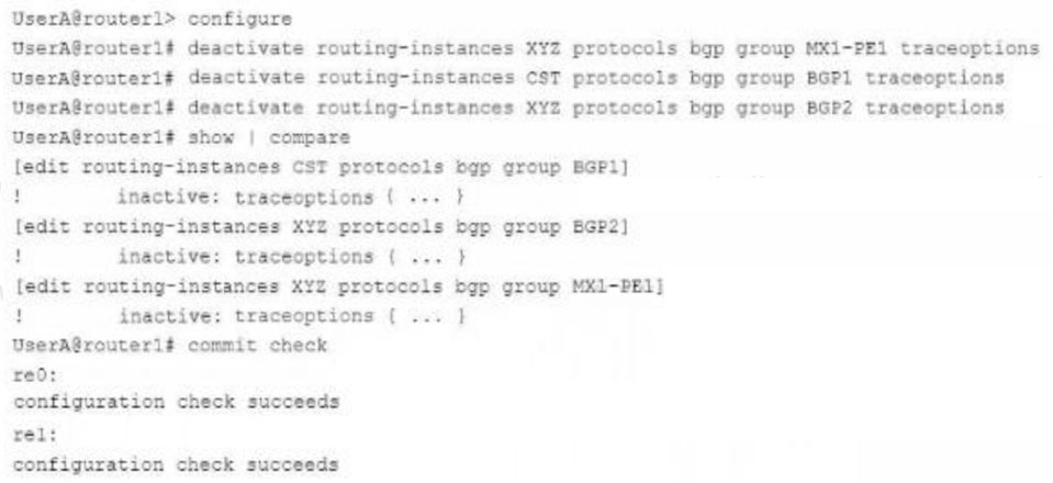

UserA is currently working on router1 and has Issued the commands shown In the exhibit. UserB wants to update the IP address currently configured on interface xe-1/2/1.0. What will UserB do to complete the configuration changes without interfering with UserA's work?
UserB should use the configure private option to complete the changes while UserA continues with the changes. The configure private option allows multiple users to make separate configuration changes in private sessions. Once changes are made in the private session, they can be committed without interfering with other users' work. This ensures that UserA and UserB can work simultaneously without any conflicts.

The answer is D, if the user A is in configure mode without committed changes, the UserB wont be able to access to private config.

To complete the configuration changes without interfering with UserA's work, UserB should use the "configure private" option. This option allows UserB to make configuration changes in a private session without impacting the configuration being edited by UserA. Once UserB has finished making the changes, they can commit the configuration. This ensures that UserA's work is not affected, and UserB's changes are isolated and independent.

D. Please look at user A using configure mode
