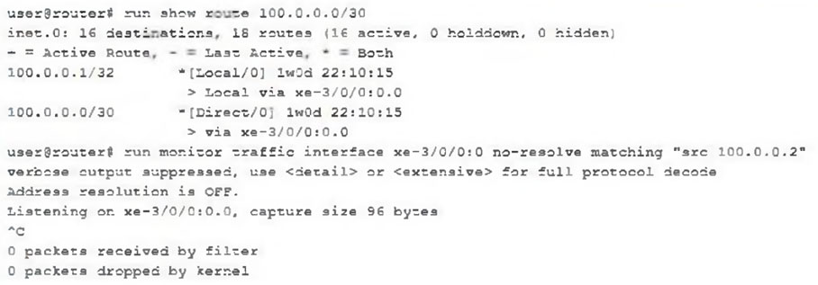

You are attempting to capture traffic being sent to IP address 100.0.0.2. but are unable to see any packets. Referring to the exhibit, what is the problem?
The issue lies in the nature of the traffic being captured. Traffic destined for 100.0.0.2 is transit traffic, meaning it is directly delivered to the connected network without being forwarded through the router. Since the traffic does not pass through the router interface xe-3/0/0:0, monitoring this interface will not capture any packets destined for 100.0.0.2.
gpt_testOption: B
Apr 28, 2023
B. Traffic destined for 100.0.0.2 is transit traffic. The exhibit shows that the IP address 100.0.0.2 is associated with a directly connected network (100.0.0.0/30) and the corresponding route is marked as "Direct." This means that the traffic destined for 100.0.0.2 is directly delivered to the connected network without being forwarded through the router. Since the traffic does not pass through the router interface xe-3/0/0:0, the capture on that interface will not capture any packets destined for 100.0.0.2.
aisa007Option: D
Nov 4, 2022
D is correct
KaFi_PaOrOption: D
Oct 18, 2022
With answer D is misstake - should be "src" not "arc"
VanDerGraafGenerator
Mar 13, 2023
Also 10.0.0.2 instead of 10.0.2.2
ToxkalcanOption: D
Oct 22, 2022
dst instead src replace "a" s with "s'
JankoHrasko1Option: D
Jan 18, 2024
believe that's D due to typos in the dump
MayTinOption: B
Jan 26, 2024
Correct answer is B
