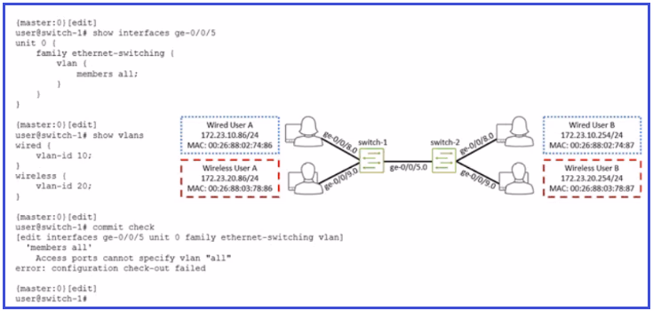

Click the Exhibit button.
Exam JNCIS-ENT Question 39
You are building a network and make some configuration changes. While trying to validate these changes, you receive the error shown in the exhibit.
How would you solve this problem?
To solve this problem, you must configure the port mode as trunk on the ge-0/0/5.0 interface. The error message states that access ports cannot specify vlan 'all'. This indicates that the port configuration is trying to include all VLANs, which is not allowed for access ports. By configuring the port mode as trunk, you enable the port to carry traffic for multiple VLANs, which aligns with the requirement to use vlan 'all'.
julin_10Option: C
Jun 15, 2024
C. You must configure the port mode as trunk on the ge-0/0/5.0 interface.
