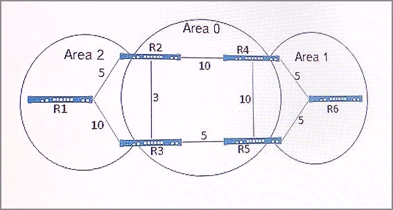

Referring to the exhibit, which path will traffic from R6 take to reach R1?
In the exhibit, the costs are labeled on the links between routers. To determine the path R6 will take to reach R1, we need to compare the total costs of each path. If R6 takes the path R6 > R4 > R2 > R1 (Option A), the total cost will be 5 (R6 to R4) + 10 (R4 to R2) + 5 (R2 to R1) = 20. Option D follows the path R6 > R5 > R3 > R2 > R1 with a total cost of 5 (R6 to R5) + 5 (R5 to R3) + 3 (R3 to R2) + 5 (R2 to R1) = 18. Since 18 is less than 20, the path with the lowest cost from R6 to R1 is via R6 > R5 > R3 > R2 > R1, making D the correct answer.
Kamili
Dec 2, 2020
the answer should be D. if we compare the total cost we get: A) 20 D) 18
Clxxcv420
Mar 2, 2021
doesnt find any argument to oppose, i aggree with answer D
alghoundar
Dec 15, 2023
The answer is D, total cost is 18 compared to 20.
