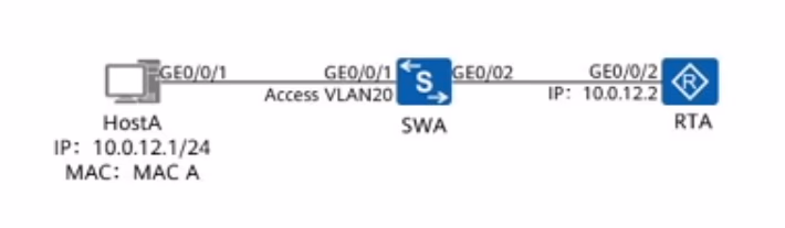

As shown in the following figure, the router uses a sub-interface as the gateway of the host and the IP address of the gateway is 10.0.12.2. Which of the following commands can be used to meet this requirement?
Exam H12-811 Question 49
To configure a sub-interface on the router for VLAN 20 with the IP address 10.0.12.2, the command set must reference the correct sub-interface identifier, which is typically derived from the VLAN ID itself. The correct configuration is achieved by using the sub-interface 'GigabitEthernet0/0/0.20' and specifying the VLAN ID 20. This matches the VLAN configuration provided, ensuring proper routing for devices in that VLAN. Therefore, the correct commands are to configure 'interface GigabitEthernet0/0/0.20', use 'dot1q termination vid 20' for VLAN tagging, and assign the IP address 10.0.12.2 with the corresponding subnet mask.

The answer is A. because the vlan ID 20 is used by the interfaz of the host.

Deberia ser la vlan 20 asignada a la interface Gi0/0/2 pero no aparece en las opciones.

I think the Answer is A, because the VLAN ID 20 is assigned to host.

interface number is wrong, so we can't save tell.

The answer is A, As per the exhibit the sub interface should be interface GigabitEthernet0/0/2.20
