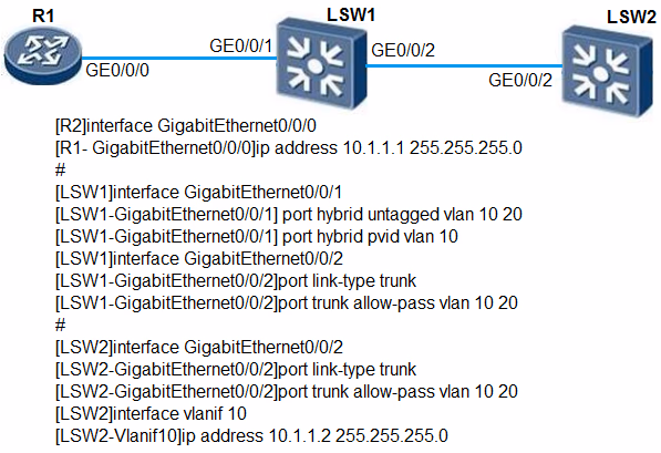

Refer to the graphic, after the ping 10.1.1.2 command is executed on R1, LSW1 receives a tagged data frame from VLAN 10 on LSW2.
Exam H12-211 Question 98
The configuration indicates that VLAN 10 is set up as tagged VLAN on the trunk ports between LSW1 and LSW2. In such a setup, traffic for VLAN 10 will be tagged. When the device R1 sends a ping to 10.1.1.2, which is the IP address configured on the VLAN 10 interface on LSW2, the response from LSW2 will return back tagged with VLAN 10 through the trunk link. Therefore, LSW1 will receive this tagged data frame.
learner_88Option: A
Dec 10, 2021
The IP 10.1.1.2 is configured under interface vlan10 and it is under a trunk port. So, the come back of the ping have to be tagged. In my opinion, the answer is True.
molochtrooper
Jul 17, 2022
Hyprid untagged vlan 10, vlan 20 is an invalid configuration by 802.1Q. You can have to tagged Vlans on a port, but not two untagged Vlans.
learner_88
Nov 26, 2021
jjbt_112
Feb 23, 2022
B. The answer will be True, if only just vlan assignment was previously configured on both switches. Example: [LSW1]vlan batch 10 20 [LSW2]vlan batch 10 20
elopez2207
May 11, 2022
it goes without saying that this has already been done
