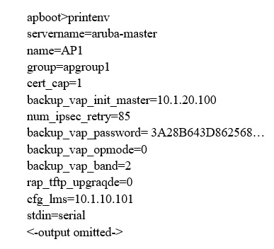

The administrator expects the AP to connect to a cluster, but the AP fails to connect. The administrator examines the configuration of an AP from apboot mode shown in the exhibit. What can the administrator determine about the configuration of the AP?
The exhibit shows that the AP is configured with a specific server name (aruba-master) and IP address (10.1.20.100) for initialization and backup purposes, but there's no indication that the AP is configured to connect to a cluster. Instead, it appears to be set up to connect to a specific, non-cluster Mobility Controller. If it were intended to connect to a cluster, there would typically be additional configuration parameters indicating the cluster information.
AsraelmirandaOption: A
Jan 14, 2020
The correct answer is A
SayedasmOption: A
May 13, 2020
should be A
god_fatherOption: D
Dec 1, 2019
answer is D:
