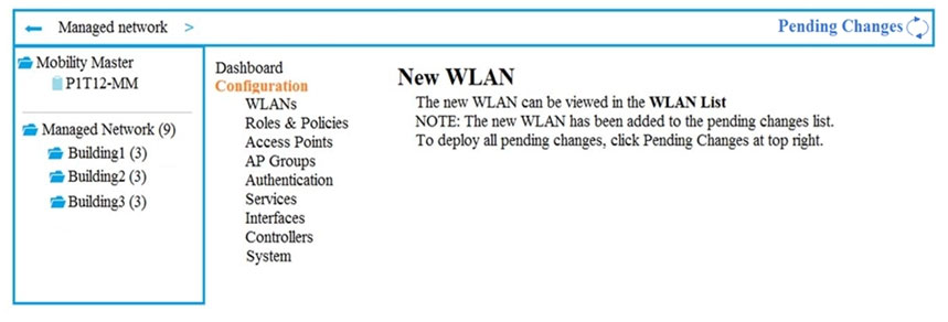

A company has an Aruba Mobility Master (MM)-based solution and needs a new WLAN for the corporate campus. A network administrator completes the creation of this WLAN, as shown in Exhibit 1. When administrators try to test a connection to the WLAN, the WLAN does not show up in the list of WLANs on the client.

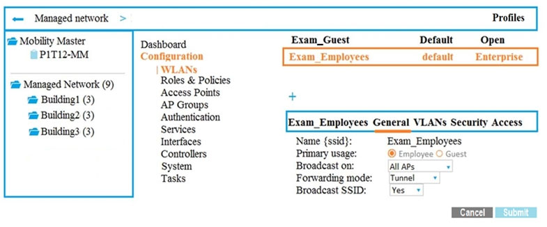

The administrator can see the WLAN in the list, as shown in Exhibit 2.

The configuration is not deployed. In Exhibit 1, the message 'Pending Changes' indicates that the new WLAN configuration has not yet been applied. To resolve this issue, the administrator needs to deploy the changes by clicking on 'Pending Changes' at the top right to make the WLAN active and visible to clients.

the configuration is not disployed(pending changes)

Pending changes

A : "pending changes" in first snapshot...It means that configuration is not deployed.

The answer would be A because in Exhibit 1 appears the message "Pending Changes"

Changes are pending

A, changes pending

Mangement Network is selected in the heirarchy, but pending config shows in top right corner of screen. Correct answer is A
