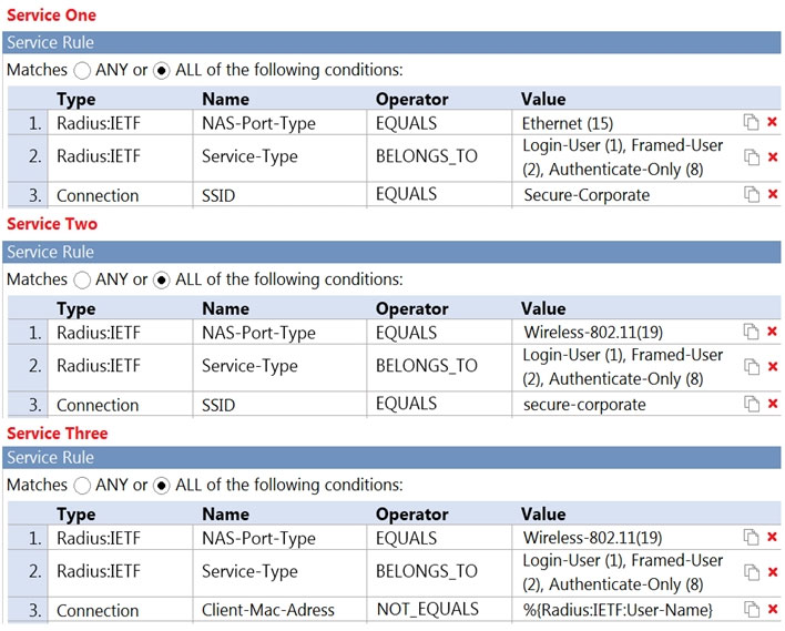

A user connects to an Aruba Access Point wireless SSID named "Secure-Corporate" and performs an 802.1X authentication with ClearPass as the authentication server.
Based on this service configuration, which service will be triggered?
The correct service triggered will be Service Two. Here's why: The user connects to a wireless SSID named "Secure-Corporate". Service One can be eliminated because it is configured for Ethernet (wired) connections only. Service Three can also be ruled out because it specifies a condition where the Client-MAC-Address should not equal Radius:IETF:User-Name, which isn't directly related to the provided scenario. Between Service Two and Service One, Service Two specifies the SSID as "secure-corporate" (case insensitive), and matches on "Wireless-802.11" port type. This precisely matches the wireless connection scenario described in the question, thus making Service Two the correct choice.

SSID named "Secure-Corporate", Service two mention "secure-corporate", lower case. A is correct

I have just tried this now by changing EQUALS SSID case from Guest to guest and a service was not matched properly. B is correct as per my suspicions. A - It matches a service. Incorrect B - Correct. C - user connecting to different title case of SSID name, Incorrect. D - Wrong NAS-Port-Type, Incorrect

A is wired only, B is correct.

B is correct. Mac is always sent so it should hit service 3. although this says do not equals it should hit the rule.

C: A is Ethernet. B is lower case SSID

My answer is A. No Service will be triggered. Service 1 is wrong because of "Ethernet". Service 2 is wrong because of lower case "secure-corporate". Service 3 is wrong because Radius:IETF Username will match the client mac address.
