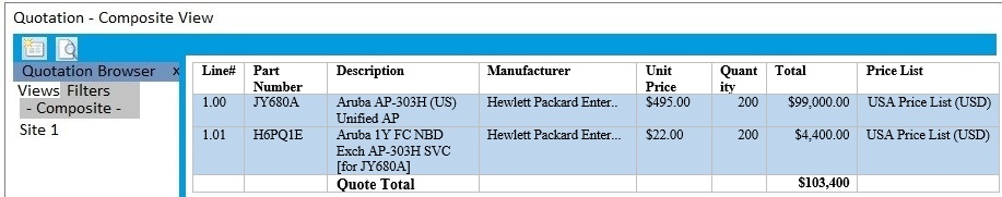

A hotel needs a wireless solution. The architect has selected 303H Series, controlled by a local MC, as the best choice. The hotel plans to have the APs installed in the existing wall boxes which have one Ethernet port each.
The architect has created to BOM shown in the exhibit. (Note that this portion of the BOM does not include the MC, which is not part of this question.)
Which additional clarification should the architect seek to determine whether this BOM fully meets the customer needs?
To ensure that the wireless solution will function properly, it is crucial to confirm whether the hotel has a PoE (Power over Ethernet) or PoE+ source. The AP-303H APs require PoE for power, and without a sufficient PoE or PoE+ source, the APs will not operate. Clarifying this ensures that the necessary power infrastructure is in place to support the deployment of the selected APs.
