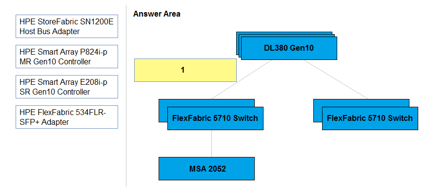

Given the solution shown in the exhibit, which adapter is required in the server to facilitate connective in Block 1
addigate
Oct 29, 2021
Answer is wrong. 5710 is an ethernet switch (used for iSCSI) so we choose the ethernet adapter not the FC.
Toast1536
Nov 3, 2021
Agreed... and the the MSA 2052 supports iSCSI: https://www.hpe.com/psnow/doc/a00008277enw.pdf?jumpid=in_lit-psnow-getpdf&qsVersion=5&ver=5
lucavmw
Aug 24, 2022
The HPE FlexFabric 10Gb 2-port 534FLR-SFP+ adapter is a fully featured Ethernet NIC that also support iSCSI and FCoE storage offloadsif required
Drakker
Jul 25, 2022
Answer: HPE FlexFabric 534FLR- SFP+ Adapter
haji_khalid
May 13, 2022
D IS THE ANSWER
l00pht
Aug 14, 2022
Agreed Flexfabric 534 is right answer.
