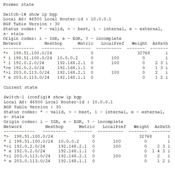

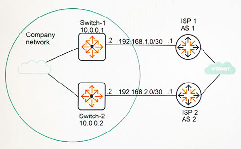

Refer to the exhibits.
Exhibit 1 -
Exhibit 2 -
Exhibit 1 shows a portion of the BGP routing table when the BGP solution was first deployed. Exhibit 2 shows the same portion at the current time. What can explain the current state?
Exhibit 1 -
Exhibit 2 -
The current state shows that the route 192.0.2.0/24 no longer includes the next hop 192.168.2.1, which was present in the former state. This suggests that Switch-1 can no longer reach 192.168.2.1, indicating a potential change in the private network.
It's clearly A because there was a change to append an AS.
