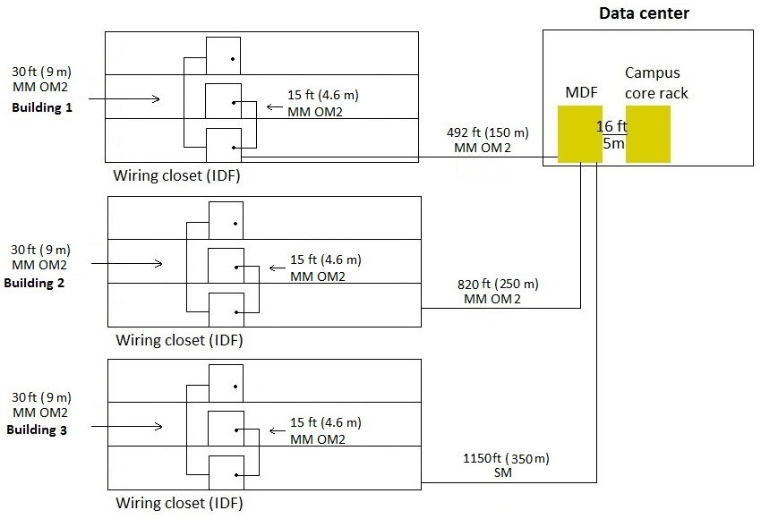

The customer has provided this figure that shows the existing cabling between floors and between buildings:

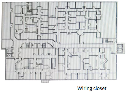

Each floor is about 100 feet (30 m) by 140 feet (43 m) with a 10 foot (3 m) ceiling. Interior walls are drywall. The layout for each floor is similar to that shown below.
CAT5e cable is extended to all areas.
What is one change to the existing network that the architect should recommend to meet the new customer requirements?
The architect should recommend upgrading to new access layer switches that support PoE+ (Power over Ethernet Plus). The current access switches only support standard PoE (802.3af), which typically provides up to 15.4 watts of power per port. However, the dual-radio 802.11ac access points, especially those with 4x4 MIMO configurations, usually require more power, closer to the 25.5 watts provided by PoE+ (802.3at). Upgrading to PoE+ will ensure that the access points can operate at their full feature set and performance capabilities.
wifi123Option: D
Sep 16, 2020
Answer is D
younbenhaOption: D
Sep 20, 2020
Answer is D, the 4*4 mimo need PoE+
