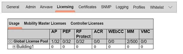

Based on the exhibit, what is the maximum number of APs that this Mobility Master (MM) solution can support?
The Mobility Master (MM) solution can support up to 32 APs as indicated by the 'AP' license count in the exhibit. The relevant column shows that there is 1 AP currently in use out of a total of 32 licenses available. This means the maximum number of APs supported by the current licensing is 32.
recca89Option: C
May 1, 2021
AP = The number of AP licenses activated or loaded into the MM MM = The total number of Associated device (Controller/AP) that can be supported by the MM Hence, the correct answer is "C"
bbccdOption: C
Jul 20, 2020
At first, I thought that the correct answer was D. Since "Based on the exhibit" and there are only 32 AP licenses, the correct answer is C.
rjoseppOption: D
Jun 22, 2020
I think that correct answer is D
kupOption: D
Sep 17, 2021
It can support up to 500 but has licensees only for 32.. I believe that correct one is C but, my mind searching for a trick , hat it must be D
