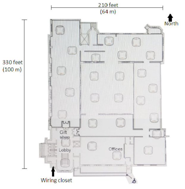

A museum wants to add full 802.11ac wireless coverage across the building, which is about 210 feet (64 m) by 330 feet (100m). The museum has 15-foot (4,6 m) ceilings and stone interior walls. The network needs to support up to 600 wireless guest devices.
The exhibit also shows a preliminary plan for AP locations. The museum has eight Ethernet drops in the lobby and gift shop, but has otherwise not been wired.
What is one recommendation that the architect should make to ensure a successful deployment?
The correct recommendation to ensure successful deployment is the addition of about 10 APs to achieve adequate density. Given the museum's dimensions and the requirement to support up to 600 wireless guest devices, a sufficient number of access points (APs) is essential to provide reliable coverage and capacity. The use of CAT5 cable, as mentioned in option C, is outdated and less relevant compared to ensuring adequate AP density. Directional antennas could help in specific scenarios but would not alone guarantee the required coverage and capacity throughout the museum.
