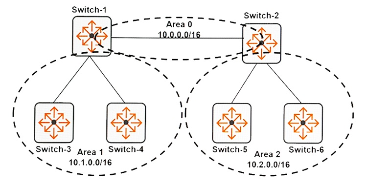

Switch-2, Switch-5, and Switch-6 currently have many OSPF routes to Area 1 networks. The network administrator wants to replace these routes with a single aggregated route to 10.1.0.0/16 on each switch. Where should the administrator specify the 10.1.0.0/16 range?
To replace the many OSPF routes with a single aggregated route to 10.1.0.0/16 on Switch-2, Switch-5, and Switch-6, the network administrator should specify the 10.1.0.0/16 range in the Switch-1 OSPF Area 1 configuration. This is because Switch-1 acts as the Area Border Router (ABR) connecting Area 1 (10.1.0.0/16) to the backbone Area 0. Summarization is configured on ABRs to reduce the number of routes advertised between areas, and thus the correct configuration should be done on Switch-1 for Area 1.
EdwinHOption: C
Mar 31, 2020
Correct answer C. You configure the area summaries on the ABR that connects to the area for which you aggregating the summaries.
GiGiWRCOption: C
May 26, 2020
yes, C is thge answer
Hugh_JazzOption: C
Aug 22, 2020
Correct, C. On the ABR with the area that has the summary.
