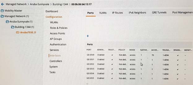

An administrator configures a split-tunnel policy to be used by RAPs at branch offices, Under the Configuration section on the Mobility master (MM) shown in the exhibit, where should the administrator configure the split-tunnel mode so that it can be deployed to the RAPs?
To configure a split-tunnel policy for Remote Access Points (RAPs) at branch offices, the setting should be adjusted under the WLAN configuration. This is where you can edit the WLAN forwarding mode, originally set to tunnel mode, to change it to split-tunnel mode. This configuration ensures that certain traffic is directed through the tunnel while other traffic is split and routed locally.
AsraelmirandaOption: A
Jan 14, 2020
A WLAN
god_fatherOption: B
Dec 2, 2019
B: is correct
sk4ttoOption: A
Aug 17, 2021
A --> Official Study Guide --> "edit the WLAN forwarding mode. Originally set to tunnel mode, the objective is to change it to split-tunnel mode"
