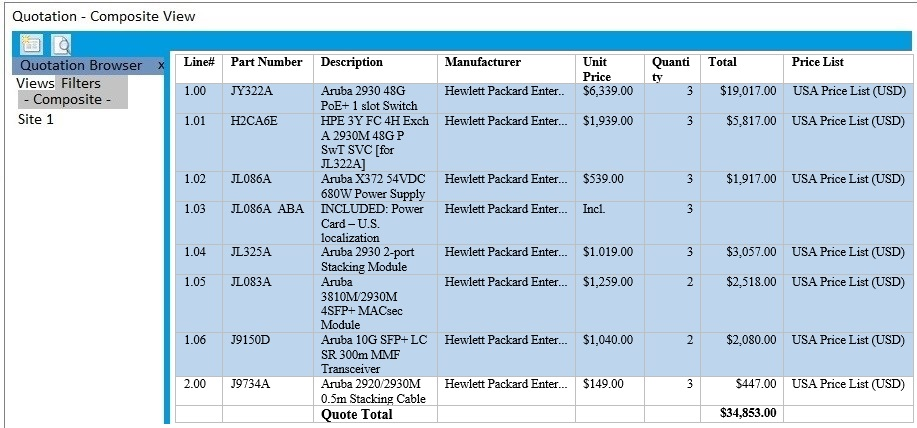

A writing closet needs to support these devices:
✑ 100 desktops
✑ 5 printers
✑ 20 AP-345s
The customer wants to single-home the AP-345s and support higher than 1GbE speeds on the AP connections to future proof. The customer also requires that the closet have two 10GbE links to the core with SR transceivers. The exhibit shows the preliminary plan for this closet.
Which correction should the architect make to the plan to meet the customer requirements?
The customer requires switches that can support higher than 1GbE speeds on AP connections to future proof their network. The existing switches in the plan are Aruba 2930F 48G PoE+ 1-slot switches, which do not have the capability to support speeds higher than 1GbE. By changing all of the switches to Aruba 2930M 40G 8 HPE Smart Rate PoE+ 1-slot switches, the architect can ensure that the switches can support higher-than-1GbE speeds on the AP connections and meet the customer's requirements. Therefore, changing all of the switches to the Aruba 2930M 40G 8 HPE Smart Rate PoE+ 1-slot switch is the correct correction to the plan.
