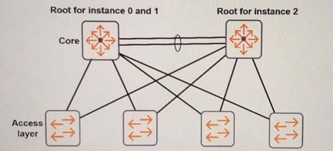

MSTP is enabled on the switches shown in the exhibit.
Which additional step should the network administrator take to support load sharing of traffic on different switch-to-switch links?
To support load sharing of traffic on different switch-to-switch links with MSTP (Multiple Spanning Tree Protocol), the network administrator should create an identical VLAN-to-instance mapping on each switch, in which some VLANs are in each instance. This allows traffic to be balanced across the different instances based on VLAN assignments, enabling effective load sharing across the network.
tmpid0Option: D
Jun 24, 2020
D is right.
Gerald007
Sep 12, 2020
I agree. The key words here are "load sharing"
cesar0724Option: D
Nov 4, 2020
D it's right for me.
