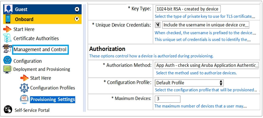

Refer on the exhibit.
Based on the configuration for "˜maximum devices' shown, which statement accurately describes its settings?
The setting 'Maximum Devices' under Provisioning Settings restricts the number of devices a single user is allowed to onboard. This means that each user is limited to onboarding a specified maximum number of devices onto the network. Therefore, option B accurately describes this configuration.
hujinkiOption: B
Aug 25, 2022
The picture is from "provisionnin Settings", not "management and control". Documentation : Onboard > Deployment and Provisioning > Provisioning Settings > Configuring General Provisioning Settings https://www.arubanetworks.com/techdocs/ClearPass/CPGuest_UG_HTML_6.5/Content/Onboard/ConfigBasicProvisioningSettings.htm#onboard_2024125842_1013571 Field "Maximum devices" : << specify the maximum number of devices that each user may provision >> Answer is "B".
