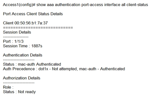

An AOS-CX switch is configured to implement downloadable user roles. Examine the AOS-CX switch output:
Based on this output, what is the state of the user's access?
The output shows that MAC authentication has passed and 802.1X has not been attempted. The 'Status' under 'Authorization Details' states 'Not ready,' which indicates that the downloadable user role is not present or has not been applied. Therefore, the user's access state indicates that no downloadable user role exists.

Correct answer is A

D is incorrect I think, you do not need 802.1x for DURs. I dont see a time out. So I think the answer is A.

Cannot be B --> dot1x is NOT in progress. Cannot be C --> There is NOT timeout Cannot be D --> dot1x is "Not attempted which means it's already configured.

Answer is A User role "Authenticated" was passed down but does not exist
