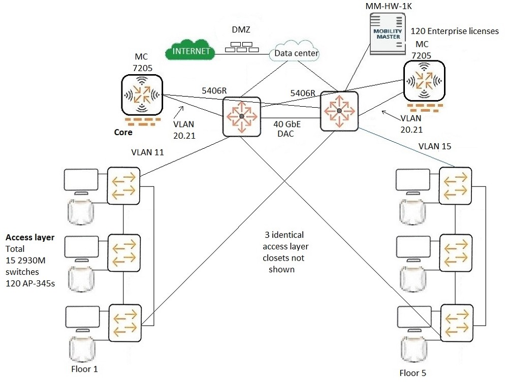

A customer has these availability requirements:
✑ loss of one controller with stateful failover and without impact on wireless client connectivity
✑ loss of one core switch without loss of connectivity for any endpoints or APs in the building
✑ loss of any one switch-to-switch or MC-to-switch link without loss of connectivity for any endpoints or APs in the building and with minimal impact on infrastructure functionality
✑ loss of any one access switch with minimal impact to wireless client connectivity
The exhibit shows the current plan for the topology.
Which change should the architect make to the plan to provide better support for the customer availability requirements?
Using two 40GbE DACs for the Virtual Switching Framework (VSF) link between the core switches improves redundancy and fault tolerance. This change ensures that the loss of a single link between the core switches does not disrupt the network, meeting the requirement of no connectivity loss in the event of any single link failure. This approach also enhances the overall network resilience by providing an additional path for data transmission, thus maintaining connectivity for endpoints and APs. The other options either do not address the specific requirements for switch-to-switch links or involve hardware not compatible with the provided network topology.
wifi123Option: A
Oct 12, 2020
Answer is A
sinanyilmaz45Option: D
Sep 29, 2020
there is not any stacking cable with a stacking module in 5406R
