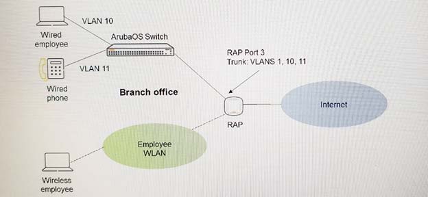

An administrator configures a policy for an AP Group. Port 3 of a RAP is a trunk that connects to a switch at a branch office. VLAN 1 is untagged and VLANs 10
(for data) and 11 (for voice) are tagged. The administrator applies an ACL inbound on Port 3 of the RAP.
How does this configuration affect traffic on Port 3?
When an ACL is applied inbound on a trunk port of a RAP, it filters traffic for all VLANs that are being carried over that trunk port. In this case, VLANs 1, 10, and 11 are all being carried over Port 3. Therefore, an inbound ACL on Port 3 will filter traffic from VLANs 1, 10, and 11.

The correct answer is D
MrvnOption: D
Jan 14, 2021
answer D - On a trunk port with many VLANs the port policy applies to all traffic.
