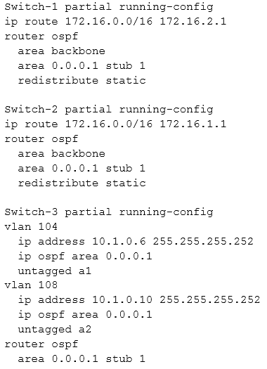

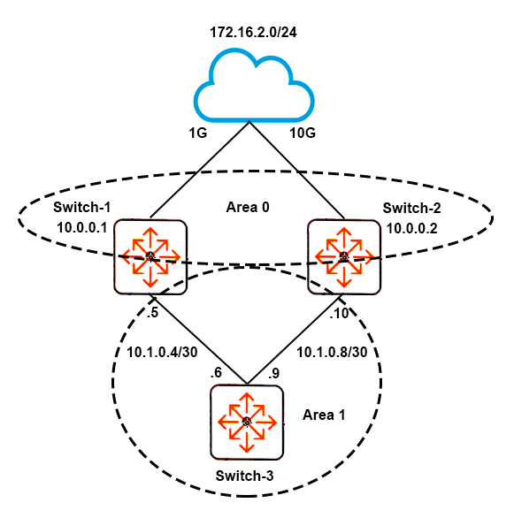

The exhibits show the current operational state for routes on Switch-3. The company wants Switch-3 to send all traffic to 172.16.0.0/16 through Switch-2.
Which single configuration change creates the desired behavior?
To direct all traffic to the 172.16.0.0/16 network through Switch-2, the OSPF cost for the default route on Switch-1 should be set higher than the cost on Switch-2. By setting a cost of 5 in the router ospf area 0.0.0.1 stub command on Switch-1, Switch-3 will prefer the lower cost path through Switch-2. This change will ensure that traffic from Switch-3 is routed via Switch-2 to reach the 172.16.0.0/16 network.

i think D is correct Set a cost of 5 in the router ospf area 0.0.0.1 stub command on Switch-1.

Agreed, this is D. Set cost of Switch 1 higher than Switch 2

i didn't find any command to set the cost of an area? Any help?
LeTan
Sep 23, 2020
router ospf area <ID> stub <cost for default route>

needs to fix the ip address on vlan108 first
