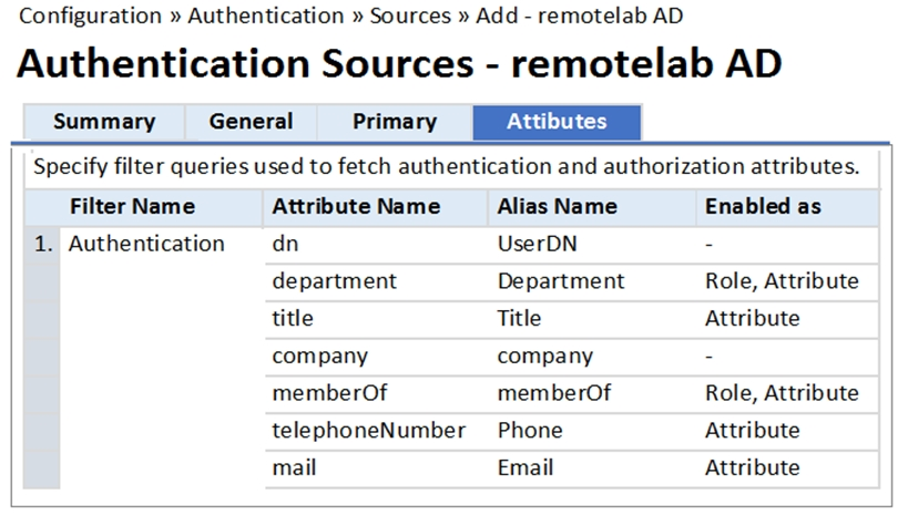

Based on the Attribute configuration shown, which statement accurately describes the status of attribute values?
The attribute configuration shows that the attributes 'department' and 'memberOf' are enabled as 'Role' and 'Attribute'. This means these attributes are directly applied as ClearPass roles. The other attributes, such as title, telephoneNumber, and mail, although enabled as attributes, are not specified to be directly applied as roles. Therefore, the statement that 'The attribute values of department and memberOf are directly applied as ClearPass roles' accurately describes the status of attribute values.
sassasaOption: B
Aug 5, 2022
B is correct
