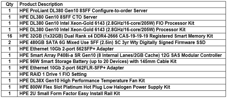

You are asked to review a server configuration for a customer before it is quoted. The server will be used in a business-critical environment and high availability is required. The server configuration is shown in the exhibit.
What should be added to the configuration to ensure availability?
To ensure high availability in a business-critical environment, it is essential to have redundancy in the power supply. Adding an extra power supply unit (PSU) guarantees that the server can continue to operate even if one power supply fails. Therefore, an additional HPE 800W Flex Slot Platinum Hot Plug Low Halogen Power Supply Kit should be added to the configuration to meet the high availability requirement.
willowltOption: C
Sep 28, 2021
You need 2nd PSU for sure. Right answer C.
rudyy
Nov 6, 2021
Totally Agree, for business-critical environment and high availability must be 2 PSU.
DentistgubaOption: C
Feb 1, 2022
Could also be extra sas controller but a bit much to have one per drive (only 2 listed). Also server could still be available in a sense with a faulty sas controller.
iomdOption: C
Mar 29, 2022
C is the correct answer
lainuxOption: C
Aug 1, 2022
Has to be C - PSU
CASKOption: C
Aug 9, 2022
C - Extra PSU
lucavmwOption: C
Aug 22, 2022
PSU also for me
