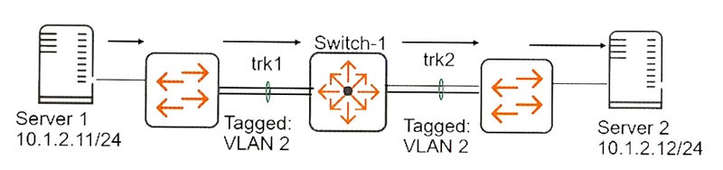

Switch-1 is an AOS-switch that is operating at factory default settings for QoS and has type of service disabled. It receives a frame with 802.1p value 5 on trk1, on
VLAN 2. How does the switch treat the frame when it forwards it on TRK2?
Switch-1 is operating at factory default settings for QoS and has type of service disabled. When QoS is at factory default and type of service is disabled, the switch treats all traffic with normal priority, regardless of the incoming 802.1p value. Therefore, when Switch-1 receives a frame with an 802.1p value of 5 on trk1 on VLAN 2, it will forward the frame with normal priority and overwrite the 802.1p value to 0.
GiGiWRCOption: D
May 26, 2020
D. by default is honored color
lmtnhohgwaOption: C
Mar 22, 2020
i Think C is correct It forwards it with normal priority and 802.1p 5
Hugh_JazzOption: D
Aug 22, 2020
D is correct. Honored and higher than normal 5.
