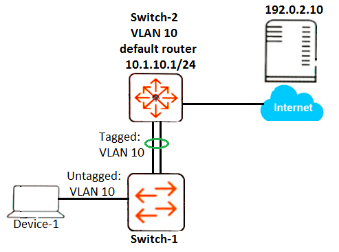

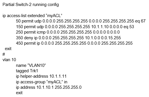

A network administrator applies the ACL to Switch-2, as shown in the exhibit. Device-1, IP address 10.1.10.10/24, attempts to open an HTTP session with host
192.0.2.10 on the Internet. What happens with this attempt?
Switch-2 filters both the traffic from Device-1 and the return traffic with the ACL. The Access Control List (ACL) applied to VLAN 10 on Switch-2 includes a deny statement for IP addresses from 10.1.0.0 to 10.1.15.255, which encompasses Device-1’s IP address (10.1.10.10). Therefore, the return traffic from the Internet to Device-1 will be filtered and dropped.

I think correct answer is B
GiGiWRCOption: A
May 26, 2020
A. both. the filter permit the outgoing traffic but incomming is deny by role.
GiGiWRC
Jun 8, 2020
my mistake. C is the answer.
