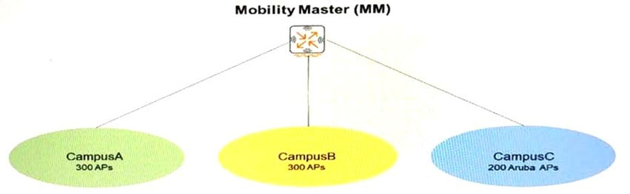

An administrator implements AP licensing on a Mobility Master (MM).
✑ Each campus is responsible to purchase its own AP licenses.
✑ There are 900 AP licenses deployed in the global pool.
✑ There are three dedicated pools.
✑ From the global pool, 300 AP licenses are assigned to each dedicated pool.
Network engineers at CampusA want to deploy an additional 100 APs. Currently all of the AP licenses in CampusA and CampusB are allocated, but only 200 of the AP licenses in CampusC are allocated.
What can the administrator do to add capacity for CampusA in alignment with campus policies?
According to the policy described, each campus is responsible for purchasing its own AP licenses. Therefore, the most appropriate solution would be to add 100 more AP licenses and assign them to the CampusA pool. This ensures that CampusA follows the policy of acquiring its own licenses without relying on reallocating licenses from other campuses or the global pool.
