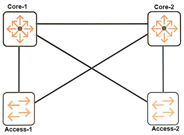

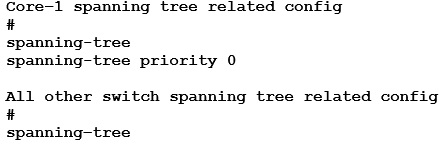

A network uses RSTP, as shown in the exhibits. The network administrator wants switches to use the link that connects to Core-2 to forward some of the traffic.
The administrator enters these commands on every switch shown in the exhibit:
The administrator then discovers that the links to Core-2 still did not forward any traffic.
What should the administrator do to enable these links to carry traffic?
The administrator should configure Core-2 with spanning tree priority 0 in instance 2. Currently, only Core-1 is configured with a spanning tree priority of 0, making it the root bridge for all VLANs. Configuring Core-2 with spanning tree priority 0 for instance 2 will make it the root bridge for the VLANs assigned to instance 2, directing traffic for those VLANs to use the links connected to Core-2.

Should be D. Spanning tree initially is RSTP, so to have 2 instances the version should be MSTP.
Xptorol
Sep 11, 2020
I was wrong. Option C is the correct one.
tmpid0Option: C
Jun 24, 2020
Should be C
