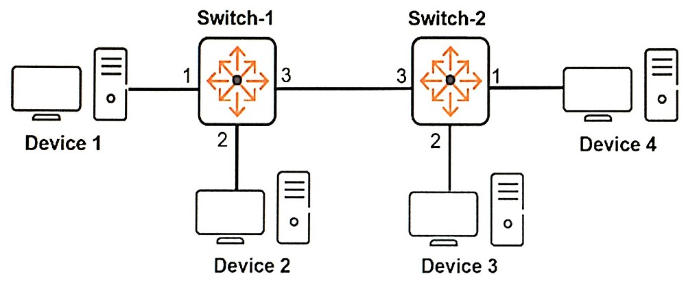

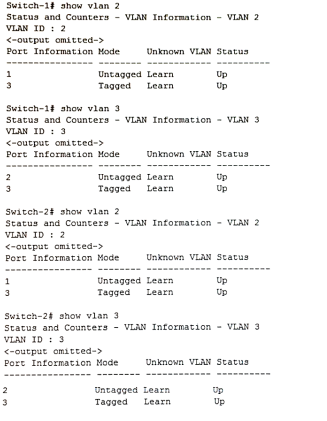

Which devices can communicate with each other at Layer 2?
Based on the VLAN configuration shown in the exhibits, Devices 1 and 4 are part of VLAN 2, and Devices 2 and 3 are part of VLAN 3. This means that devices within the same VLAN can communicate at Layer 2 while devices in different VLANs cannot. Therefore, Devices 1 and 4 can communicate with each other, and Devices 2 and 3 can communicate with each other at Layer 2.
tmpid0Option: D
Jun 24, 2020
D is right. Devices 1 and 4 are in VLAN 2, devices 2 and 3 are in VLAN 3.
