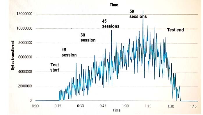

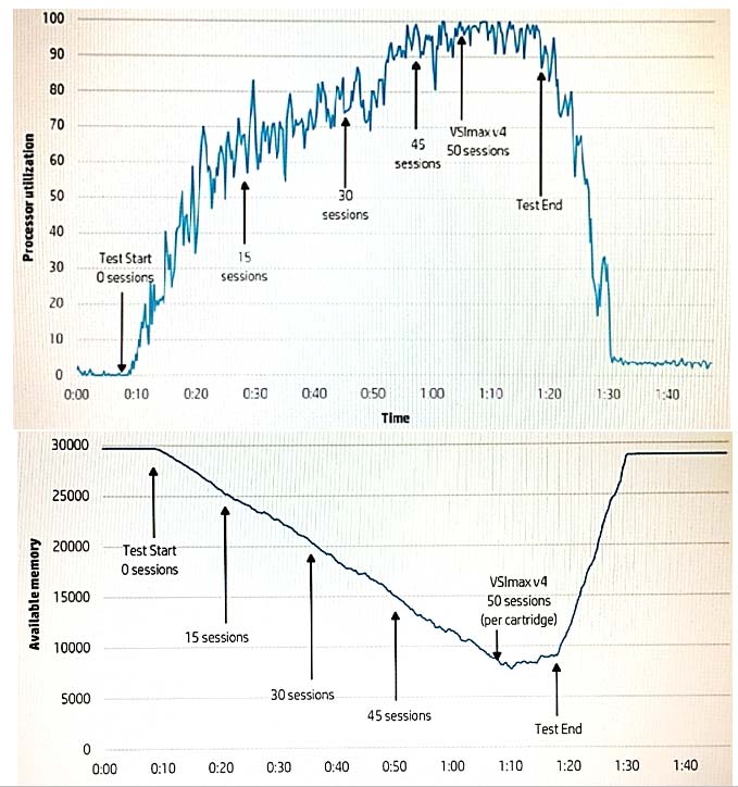

Refer to the exhibit. An architect is planning an HPE Moonshot System with m710 cartridges to support a customer application virtualization solution. The customer indicated that the maximum acceptable response time for the solution is three seconds. The architect has implemented a POC and tested a single cartridge with different numbers of user sessions.
The architect monitored resource utilization throughout the tests. The results of the test with the point at which the response time exceeded three seconds are shown, marked as the "VSI max."
What should the architect conclude from this test?
The graphs show that processor utilization becomes high and relatively stable around 90% when the number of sessions reaches 50. This indicates that the CPU is a limiting factor at this level of user load. As a result, proposing at least one cartridge per 45 or 50 users would ensure the system maintains acceptable performance without exceeding the maximum acceptable response time of three seconds. Therefore, the correct conclusion is that CPU becomes a limiting factor around 50 sessions, and the architect should propose at least one cartridge per 45 or 50 users.

A) should be correct
