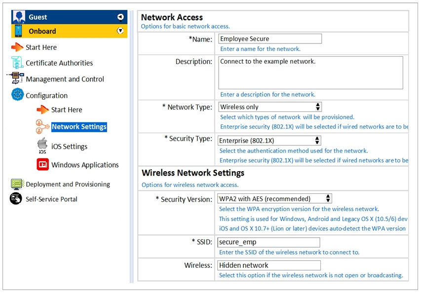

Which statements accurately describe the status of the Onboarded devices in the configuration for the network settings shown? (Choose two.)
Correct Answer: DE
The configuration shows that the network uses Enterprise (802.1X) security, which means that 802.1X authentication will be required when connecting to the SSID. Additionally, the SSID specified for the wireless network is 'secure_emp,' indicating that devices will connect to this SSID after provisioning.
hujinkiOptions: DE
Aug 25, 2022
See cleapass documentation : Onboard > Onboard Configuration > Network Settings > Configuring Basic Network Access Settings https://www.arubanetworks.com/techdocs/ClearPass/CPGuest_UG_HTML_6.5/Content/Onboard/ConfigBasicNWAccessSettings.htm field "security type" is set to "enterprise" -> no PSK so "D" is correct field "name" is just a label, field SSID is the name of the SSID so "E" is correct
