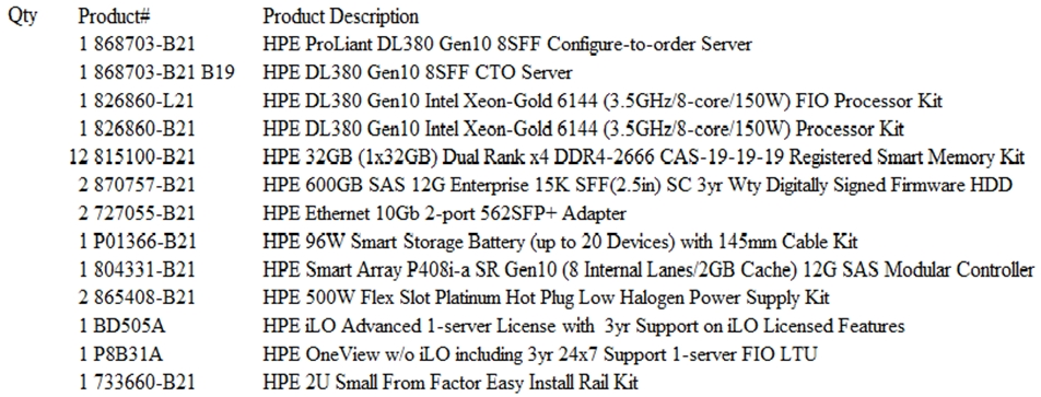

A customer needs a server with four 10Gb network adapters. They need it to be configured for the best possible network throughput.
Given the BOM in the exhibit, what do you need to add to this server to meet the customer requirement?
To meet the customer's requirement of having a server with four 10Gb network adapters for the best possible network throughput, adding a Secondary Riser Kit is necessary. This allows additional PCIe slots needed to support the four network adapters. The other options provided are not relevant to increasing the network adapter capacity or network throughput.

dual CPUs should require dual risers

DelHQOption: D
Sep 24, 2020
D: Secondary Riser Kit is the correct answer, the requirement is for 'four 10Gb network adapters' not four ports (which already exist on the BoM as two cards), since the primary riser is 3 slots the secondary riser is needed to fit 4 cards or more. Note: EYE's comment should be the other way round, you need two CPUs for the secondary riser card to work (one Xeon CPU doesn't support enough PCIe lanes).

PsycosisOption: D
Sep 15, 2020
A workload accelerator is a NAND storage device, and some of the other answers are storage based and don't feel right. The riser seems like the correct answer as you need the riser to add another card when there are 2 CPus used and you want more network ports. ( I have actually purchased this before for a client to address this issue)
DelHQOption: D
Sep 24, 2020
Reading the question a different way and assuming they mean 4 ports not adapters D: is still the correct answer since it will balance the network / NIC workload across both CPUs. Besides, all the other options affect storage performance only, not network as Psycosis points out.
CASKOption: D
Aug 10, 2022
To be able to place four network adapters, you need a secondary riser.
