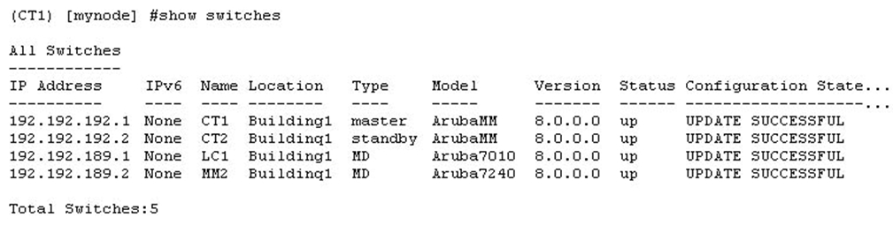

What can the administrator determine from the configuration shown below?
The configuration shown indicates the presence of a master and a standby Mobility Master (MM). In such a setup, Virtual Router Redundancy Protocol (VRRP) is typically used to provide redundancy and ensure seamless failover. This redundancy is crucial for maintaining the availability and reliability of the network. Therefore, it can be determined that VRRP is used for Mobility Master redundancy.

How does the output show that VRRP is running? Is that simply because we have a master and standby MM?
Zani
Nov 24, 2020
Yes, Master and Standyby MM would tell us VRRP has been configured for MM redundancy
