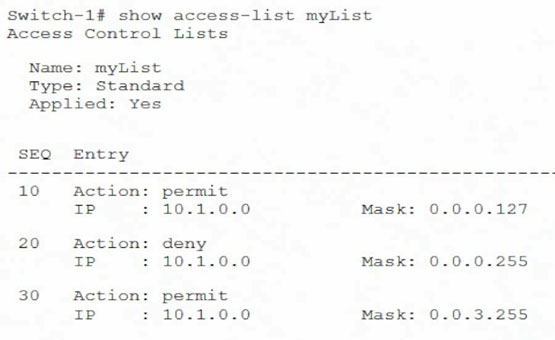

A network administrator applies the ACL shown in the exhibit. Which source IP address does the myList ACL deny?
Examining the access control list (ACL), we see three entries. The first entry permits IP addresses from 10.1.0.0 to 10.1.0.127. The second entry denies IP addresses from 10.1.0.0 to 10.1.0.255. The third entry permits IP addresses from 10.1.0.0 to 10.1.3.255. Given option A, 10.1.0.10 falls into the range covered by the second entry, which denies it. Therefore, 10.1.0.10 is denied by the ACL.
barsoom1980Option: D
May 14, 2020
the D is answer correct
Hugh_JazzOption: D
Aug 23, 2020
D is correct, agreed
udo2020Option: D
Sep 20, 2020
D is right! Because of the implicit deny at the end.
EdwinHOption: A
Mar 31, 2020
I think correct answers is A
EdwinH
Apr 5, 2020
Correct answer is D.
