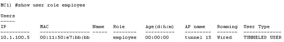

Once connected to a WLAN, a user cannot reliably access resources in a company's network. Based on the output shown in the exhibit, what can be determined about the users connection?
Based on the information provided in the output, the user's connection can be determined as follows: The 'Roaming' field is marked as 'Wired,' which indicates the user is not connected wirelessly. The 'AP name' field shows 'tunnel 15,' which signifies the use of a tunneled node in the network. The 'User Type' is shown as 'TUNNELED USER,' further indicating that the user is connected through a tunneling mechanism. Therefore, the user is connected to an ArubaOS-Switch, which supports tunneled node configurations.
guy12Option: D
Oct 18, 2021
its D i Think
pabx31
Jan 7, 2022
Roaming=Wired so connected to switch AP Name = tunnel 15 so using tunneled node from switch VIA would show AP Name = VIA-VPN
