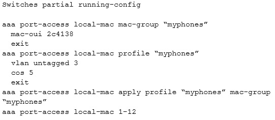

Exhibit 1 -

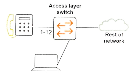

Exhibit 2 -
A company does not require authentication for security, but AOS-Switches are set up to use local MAC authentication (LMA) to assign the correct VLAN and priority to IP phones. IP phones and computers belong to different VLANs. Each device is supposed to connect to a specific port, but sometimes users connect their devices to the wrong ports and cannot receive access without help from IT.
How can a network administrator configure the switches to eliminate this issue?
To ensure that devices can connect correctly without IT intervention when users plug them into the wrong ports, applying local MAC authentication (LMA) to all edge switch ports and setting the unauthenticated VLAN to the user VLAN is the best approach. This configuration ensures that devices are assigned to the correct VLAN regardless of the port they connect to, thereby eliminating connectivity issues when devices are connected to the wrong ports.
