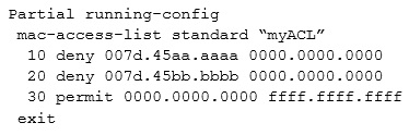

An AOS-Switch has the ACL shown in the exhibit. A network administrator then enters these commands:
Switch(config)# mac-access-list standard myACL
Switch(config-std-macl)# deny 007d.45cc.0000 0000.0000.ffff
How does this ACL treat these frames:
1 = 007d.45cc.ffff 2 = 007d.45cc.0000
The ACL treats frames based on the matching rules specified. The entry 'deny 007d.45cc.0000 0000.0000.ffff' will deny any frame with a MAC address in the range 007d.45cc.0000 to 007d.45cc.ffff. Thus, frame 1 (007d.45cc.ffff) falls within this range and will be denied, while frame 2 (007d.45cc.0000) exactly matches the rule and will also be denied.

I think correct answers is B
GiGiWRCOption: B
May 26, 2020
B. New entry is created after permit action so permit is applied 1st.
