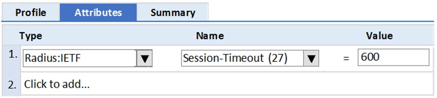

An Enforcement Profile has been created in the Policy Manager as shown.
Which action will ClearPass take based on this Enforcement Profile?
ClearPass will send the Session-Timeout attribute in the RADIUS Access-Accept packet to the Network Access Device (NAD). The NAD will then end the user's session after 600 seconds. This is a standard behavior of the RADIUS protocol where the Session-Timeout attribute is included in the Access-Accept packet, and it's the responsibility of the NAD to enforce the session termination after the specified timeout period.

asdfgdrOption: B
Oct 29, 2020
B is correct. D is wrong cause of the Access-Request
Robby907Option: B
Oct 25, 2020
i think the right answer is B
younbenhaOption: B
Oct 30, 2020
B and D are the same answer , and B is the correct answer.
asdfgdrOption: B
Oct 28, 2021
B & D are NOT the same. B is RADIUS Access-ACCEPT where C is RADIUS Access-Request. B is correct.
[Removed]Option: D
Oct 19, 2020
D is the right answer
LeTanOption: E
Dec 15, 2021
E correct This Attribute is available to be sent by the server to the client in an Access-Accept or Access-Challenge.
MaryahAGOption: D
Feb 3, 2022
I think it's D, referring to this question where B was not even an option. https://www.examtopics.com/exams/hp/hpe6-a15/view/6/
MaryahAG
Feb 3, 2022
Sorry, it's B because it should be Access-accept not Access-Request
FyrithOption: B
Mar 22, 2023
B should be correct, Session Timout is send to the NAD with an accept.
